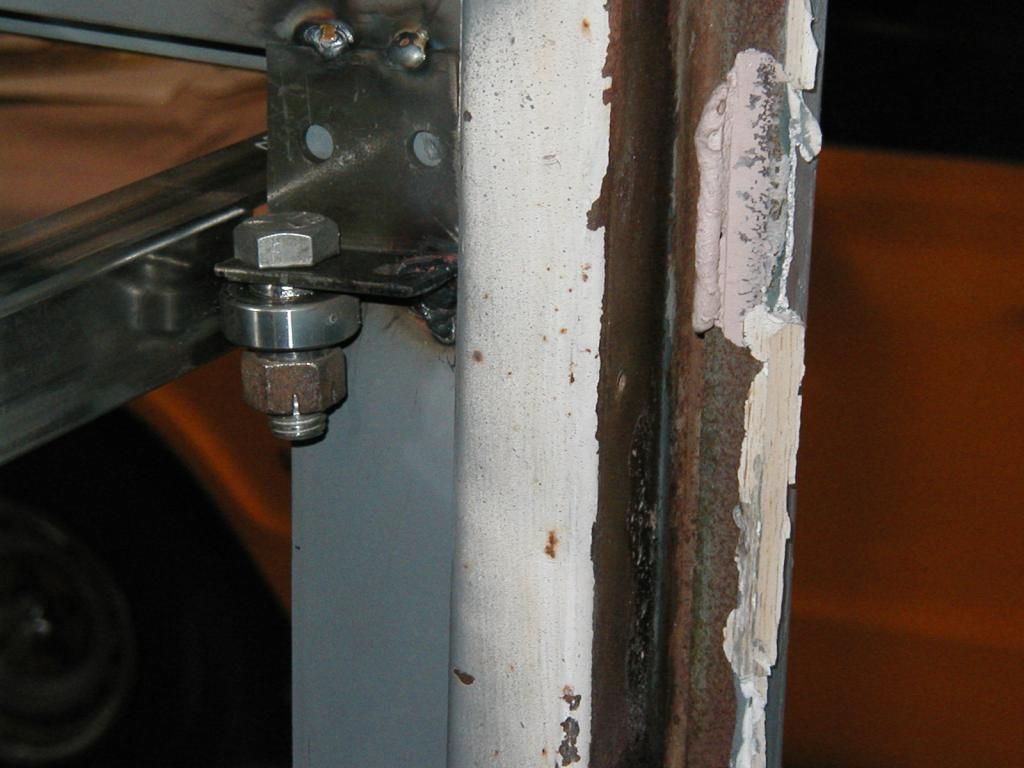

I added a pair of rollers near the top of the slide out to force the box to track a straight line. Because these rollers interrupt the slide out seal to some extent I thought it best to position them as close to the roof overhang as possible thereby reducing the amount of water they see. We'll see.Image

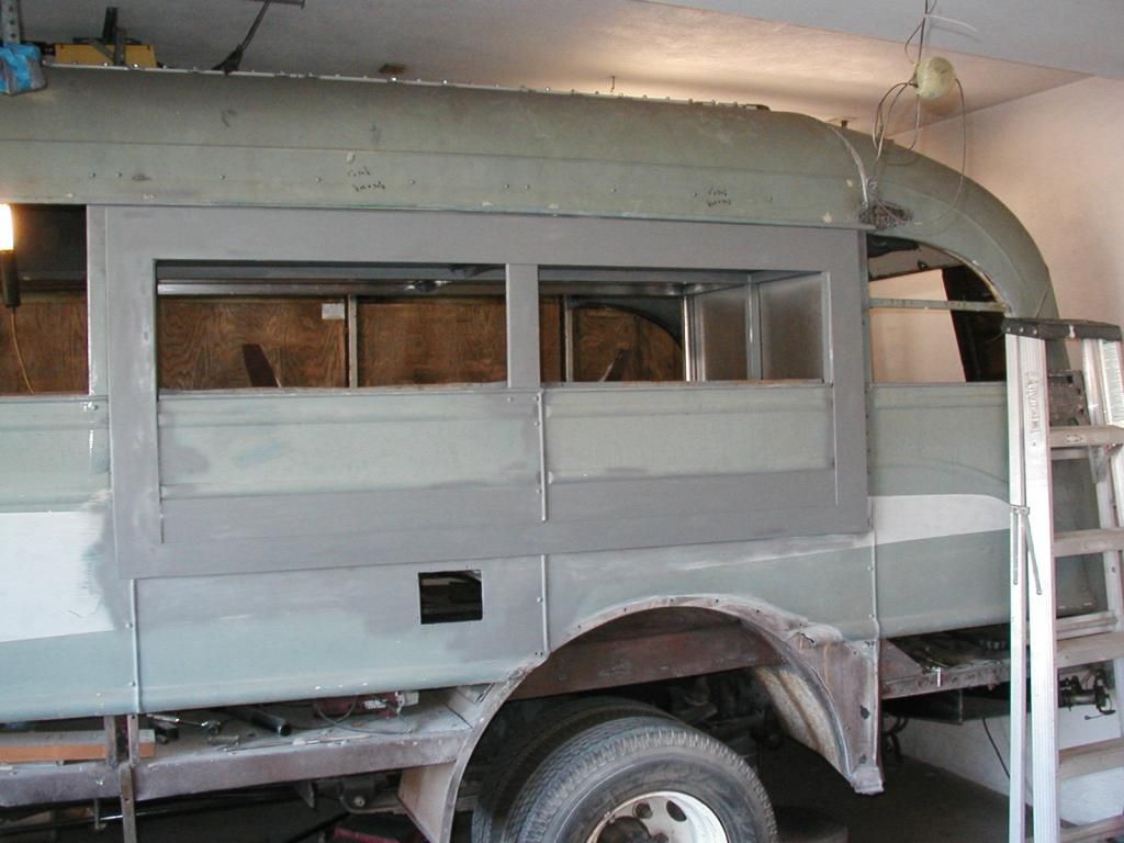

The original bus panels have been cut and fit to the pop out ready to weld. Strips of 1/8 " thick flat strap (of various widths) will be plug welded to the skin and pop out frame and will extend over the gaps and over the bus body with a compression seal between the strap and the bus body when the pop out is retracted. A similar seal will seal to the inside of the bus when the pop out is extended.Image

I finished up the inside and outside seal strips today and am happy with both fit and function. Next I'll install a plywood floor and some insulation. Once that is done I'll skin the inside and deal with the windows. Jack
Pop out extended.Image
Pop out in.Image

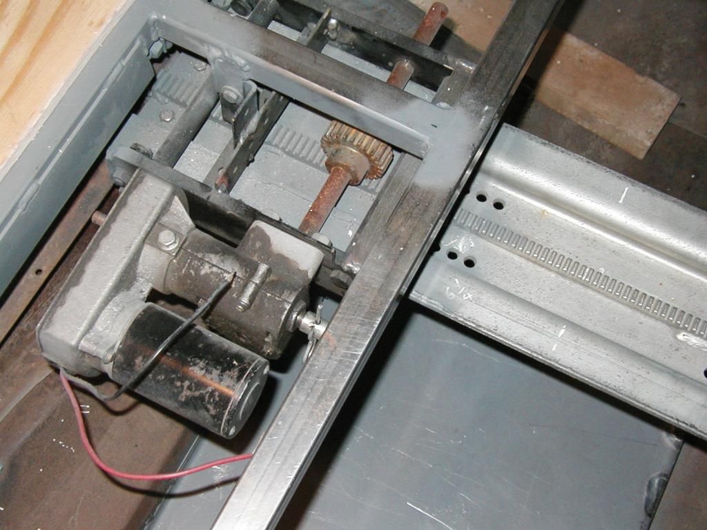

Hey Jim. I couldn't resist using a motor on the slide out. I bought an unused slide drive on ebay for $75 delivered. It is a rack and pinion affair with a 18 to 1 drive ratio.The track is 1/4" plate formed into a channel with wings along the side--very rigid. The drive mechanism is supported by 8 rollers 4 on top and 4 on the bottom which controls the leverage generated as the box slides out. Since the whole slide out is mounted on roller bearings there is almost no moving resistance for the motor to overcome so I am hopefull that the drive mechanism will be long lived. I did, however, provide an easy access plate which will allow me to disconnect the drive should it fail. The slide could then just be pushed in and out. As to weather seals I think I have come up with something that will work--we'll see! Jack

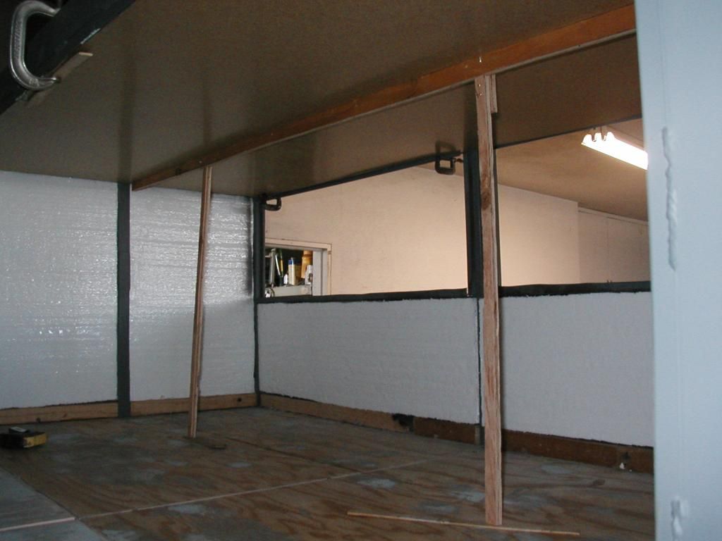

Hello All. It wasn't as hot today as it has been for the last week (90 degrees, high humidity arg) so working on the bus was more of a treat. I completed the floor and insulation for the slide out and test fit the steel "window" panes in their sash.
I looked around Lowe's and Home despot in particular at their dual glaze sliding windows. I'd like to use dual pane tempered glass for the side windows and having the glass fit to my existing frames looks like it will be very costly--about 3X the cost of special ordered residential windows. Most of the new residential windows seem to have plastic frames which I am not too crazy about but they look good and don't look too hard to make work. Any thoughts on this? Jack
Slide out floor and insulation. I have not yet built the stationary portion of the bed frame.Image
Jim, here is a close up pic of the slide out drive. Image

Hello All. I finished up the insulation on the slide out and installed the interior panels. I built a "jack" to help support the ceiling while the mastic cured and I placed self taping screws to hold it in place. Eventually I will paint the exterior top and side surfaces with glossy white enamel and upholster the inside with a thin carpet material. The front surface will be painted to match the side of the bus. Jack
"jack" to support the ceiling. The legs are on a pivot so I could adjust the lift and pressure. Image
"jack" in place.Image
Completed interior walls.Image

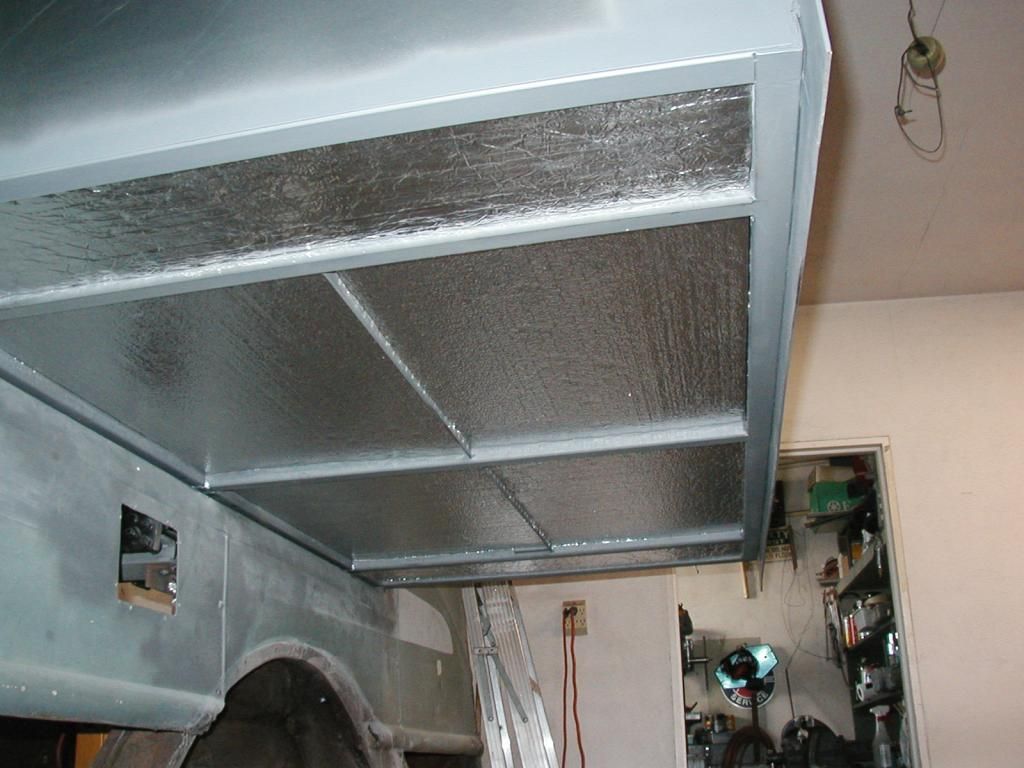

At the last minute I decided to insulate under the slide out and used foil backed foam. Image
