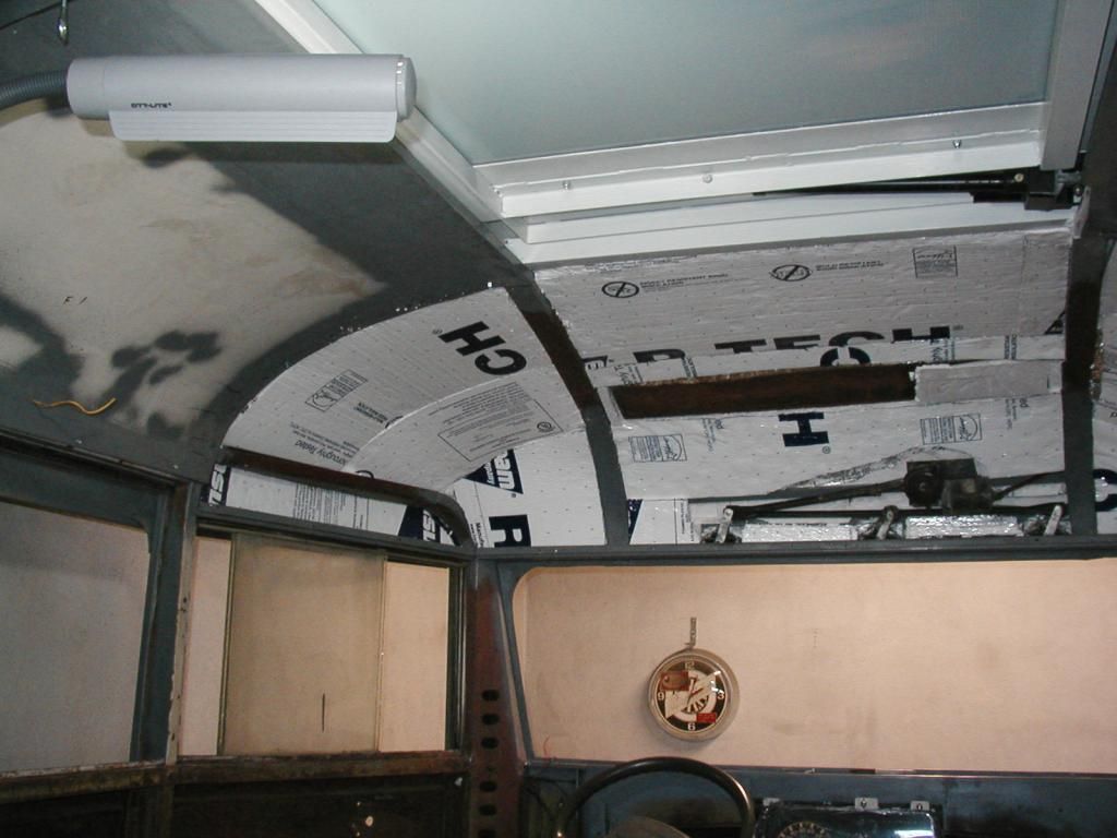

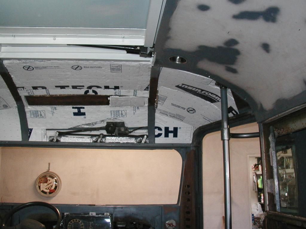

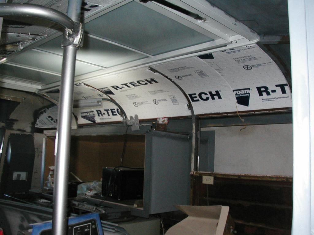

I've spent most of the week installing sheets of foam insulation in the roof of my bus. I finally have the entire roof completed and the inner steel headliner in place. I used Great Stuff to fill in the voids along the edges of the foam board and while it does what it is susposed to do it wasn't much fun. I discovered that if the can is cold (50 degrees F) no workie. That required the use of a hot water bath to keep the juices flowing. Next I discovered that "frothing" doesn't happen when you spray the stuff at cold temps--at least not until you have given up waiting. But then watch out!!! The stuff nearly explodes out of all the little openings and cracks. I'd decided to leave the bus and return to check after lunch. Just as I stepped in under the roof, the foam let go and globbed a wad into my hair--oh s---! I'm now sporting a VERY short hair cut (think Caddy Shack)
Actually, cleaning up the cured foam isn't all that bad. I used a hand held hacksaw blade and trimmed away the excess froth to develop the proper contours. Still, I think the word Great in Great Stuff probably should have been OK as in OK Stuff

Two inches of foam board over the pop out.
More foam
Front of bus.
Again.
I ended up using 3 inches of foam over the front driving area as there was ALMOST enough room. The result was that I had to use my port-o-power to compress the foam a bit so that I could install the front inner sheet metal. I'll be paying for that clever idea in sore muscles.
I found some unused framing in the area just above the drivers window. Perhaps this was designed in for european delivery as the section was an unused mirror of the top of the right hand door. I turned the recess into a "glove box" as there isn't one in the dash.
