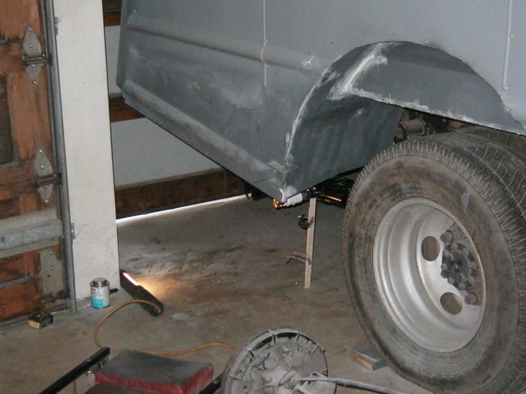

Hello All. I completed the flooring and now am in search of a roll of linoleum. I screwed the flooring to the floor of the bus and back filled all the holes with body filler and sanded to flush. I hid a photo of the finished job somewhere in Photo bucket and if I ever find it I'll post it.
Most of the past week was spent completing the drain for the black tank and wiring up the macerator. After 4 trips to the hardware store to buy, try and return pipe and fittings I came up with a fairly simple way to get pipe, slice valve, macerator and switch jammed into the 24" X 18" space between the black tank and the rear wheels. The tank dumps on the passenger side of the bus due to space limitations on the driver's side. Since I'll be using a 5/8" garden hose to dump with rather than the usual 3" slinky tube it shouldn't be too cumbersome. At the last minute I decided to extend downward the inner rear fender to help keep the wheels from kicking road gunk all over the plumbing--no pic of that yet. Jack
Trial layout # umteen--looks like it'll work.Image
All set to glue. Image
View of installation from about 10' away.Image
Another view. I lengthened the inner fender to protect the plumbing which still shows in this pic. Image

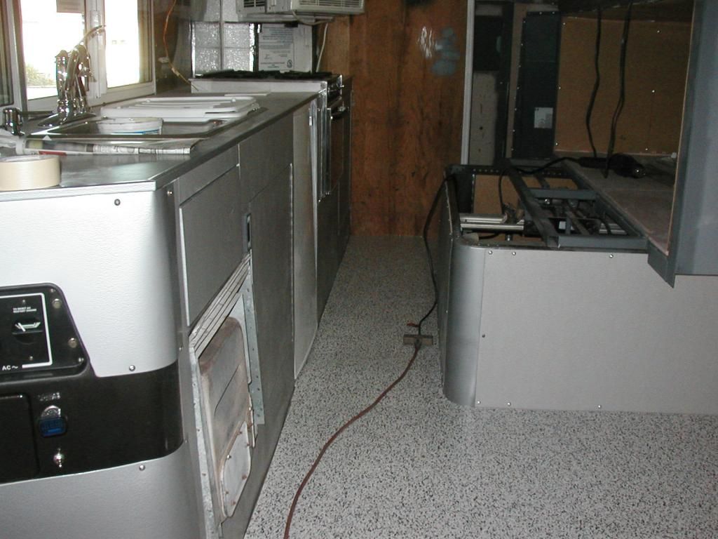

Hello All. I'm all excited. I found the perfect (in my mind at least) floor covering for my old skool bus. The stuff looks just like the Terrazo floors that became popular in the 20's once heavy electric floor grinder/polishers became available. The real Terrazo is cement with marble chips pressed into it, ground smooth and polished. The stuff I found looks just like it. It's commercial flooring from Armstrong that has been out of production for over 30 years. The good things about it are that the "pattern" goes from the surface to the backing and the surface is extreeeeemly hard--that is great as far as foot traffic is concerned but made the stuff hard to trim and install. Wiffy has that carpet runners for cold toes look in her eye. We'll see. Jack
Hard to tell from the pics but the floor color looks sort of like freshly exposed granite. Image
A view through the kitchen. Image
Another Image

MMMMMM...Me likey! --- Does indeed look like terrazzo (hides a lot). Where in the world did you find such flooring?

Hey Tango, I'd been looking for the marble looking lino that Roach used in his bus but I guess he got the last of it. I knew I wanted "old fashioned" lino to go with my old bus so I ended up driving from one little mom and pop carpet store to the next and after a couple of days at it I found just enough of the terrazo looking stuff to get the job done. The edges were damaged from shop wear and there really wasn't enough left to do a regular sized bathroom without a couple of seams so the sales lady offered it to me for $15 and a promise to show her the bus when it is complete--I jumped at the deal! I have since found a length of rubber edging shaped in cross section like the letter "P" which will dress out the joint between the lino and the walls. It will leave an approximately 1/4" grey bead along the joint. Jack
