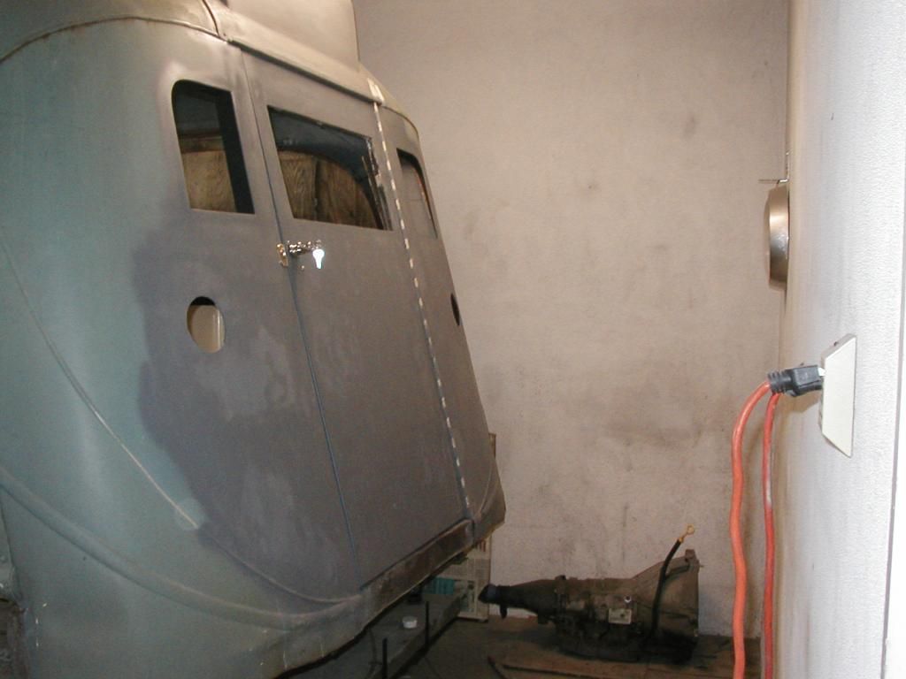

BTW --- Here is the gearbox. It is from an '03 NPR.
The only fluid on it is from cutting the lines but I'm having it rebuilt anyway.

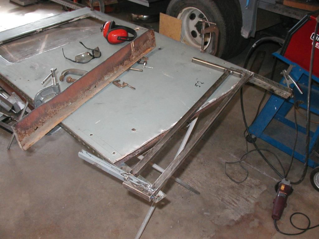

Hello All. Oh Boy, just a couple of more steps and I'll be ready to install the water heater. I finished the rust repair on the rear door and reversed the piano hinge and latch so the door now opens left to right thereby making it possible to use it as an emergency exit. The change was necessary because the bathroom blocked the path when the door opened right to left. The door needed rebuilding anyway so changing the swing only added a couple of days work. Jack
I cut off the bottom 4" of the door to remove the rusted area and then welded up a mini frame to use as a base for the replacement sheet metal. I discovered that the door was framed out internally with some beautiful oak wood. All but a bit of the wood could be reused so I left it alone. A broken rear window is no doubt what caused the door to rust as water could run freely into it.Image
I plug welded the frame into the bottom of the door and then welded sheet metal to the outside surface. I left the inside open as I will cover the entire inner surface of the door with upholstry of some sort.Image
The door fits and works acceptably well and I'll install the door sill tomorrow after it comes out of the rust strip tank.Image

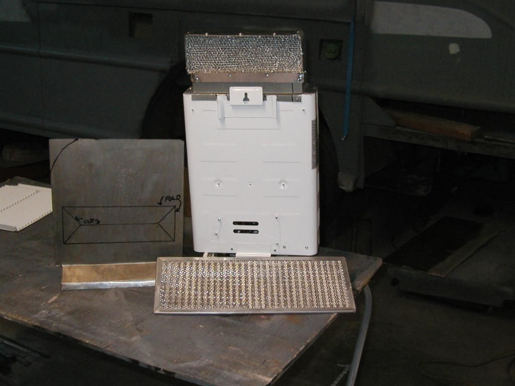

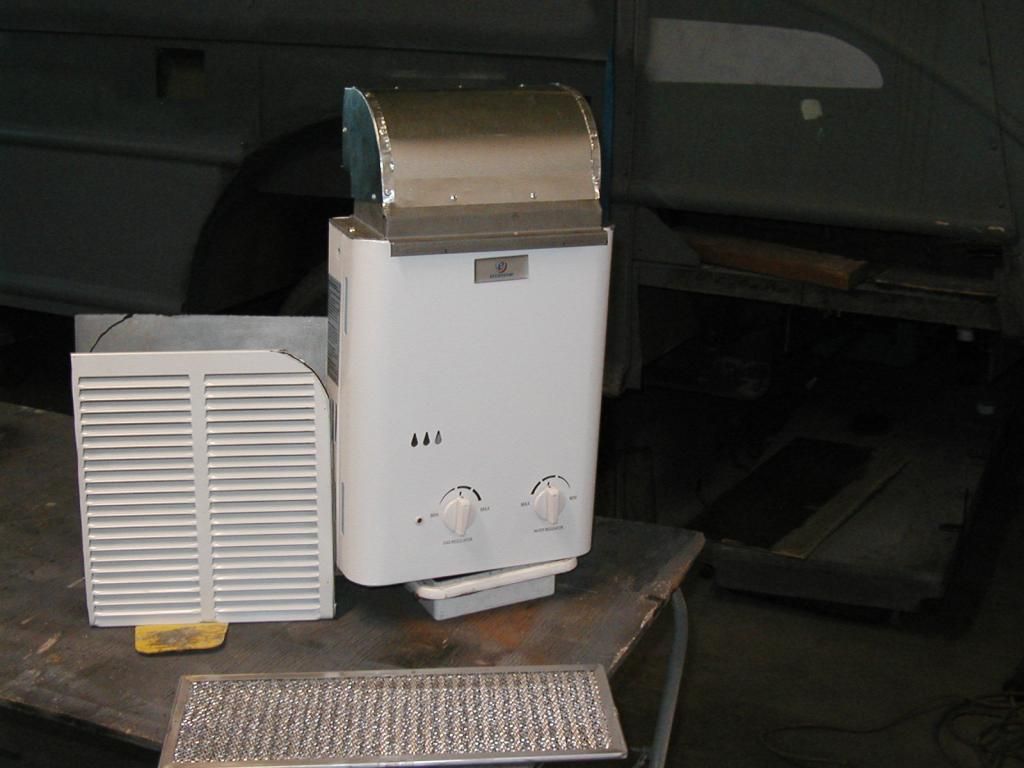

After considering the little research project I did the other day, I decided to move the water heater exhaust a little closer to the vent. This saved me some extra duct work time and labor. I'll check the temps at the vent before I seal the whole thing in and hopefully it will be ok. Jack
I shortened a 10" 90 degree sweep to match the discharge port of the water heater and then built an adaptor flu to hook up to the WH exhaust. I used 1/2 thickness fume hood screen to keep animals from making a home in the duct. The curved part of the duct will be attached to the inner plate of the "window" vent.Image
This pic shows the front of the heater and the louvers that will replace the glass window. I'll use the fume hood filter in the floor of the bus as the source of combustion air.Image

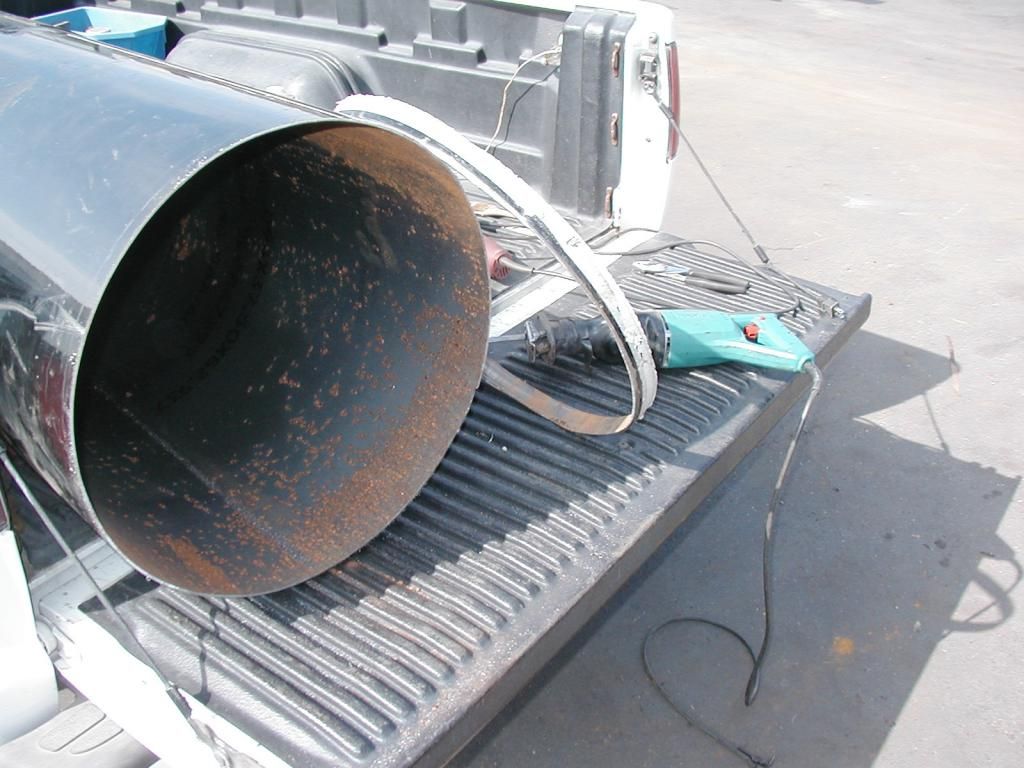

Hello All. Well, I'm a tired bunny tonight. I spent most of the day grinding the round ends off both of my compressors and came up with enough good stuff to make a "new" compressor. Foolishly I didnt have a long shirt and ended up with a million tiny spark burns on my left arm and left side of my face--must be what Botox feels like :lol: . I did have eye and ear protection so no big deal. While I was back at the house gathering more grinding discs a cop friend who is still working stopped by and mentioned that a mutual friend was selling off equiptment from his hobby shop and did I know anyone who needed a 9000# 12' Bend Pac auto lift. I called my buddy Jeff who owns the junk yard I often use when I'm going to make a lot of noise and $700 later he had a near new lift. I'll spend Saturday helping him set the thing up in his shop building. I was glad to be able to do something for him as he has been more than generous with me.
Gary, another friend, who is certified to weld pressure vessels agreed to weld my bits and pieces into a new tank in exchange for the extra pump and motor I now have 8) . Take that you cheap s*#*# Chinese----I'd probably better acknowledge the one really good Chinese product that has served me well (and put up with me) for about 35 years-- my wife-- now Harbor Freight, what a bunch of CRAP!!!!

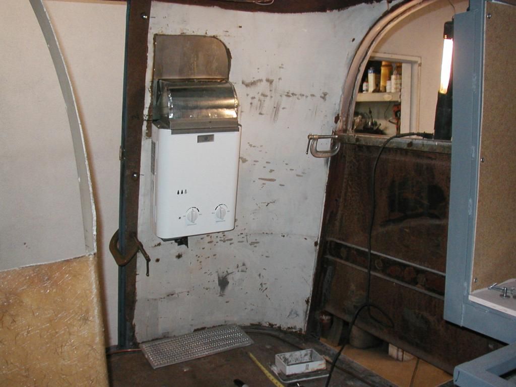

Hello All. After another day hacking and grinding on my compressor I did manage to save enough energy to fit the Ecotemp water heater to the rear of my bus. Next I'll build the air tight closet to cover the water heater. Jack
I welded in brackets by which to mount the water heater to the inner rear wall.Image

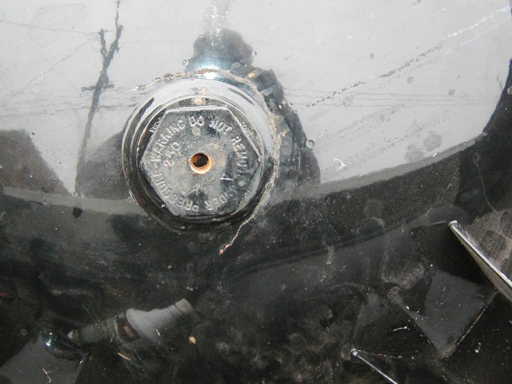

A few pics of the compressor saga. Here at 12 o'clock is the little hole that started the "hole" fiasco.Image

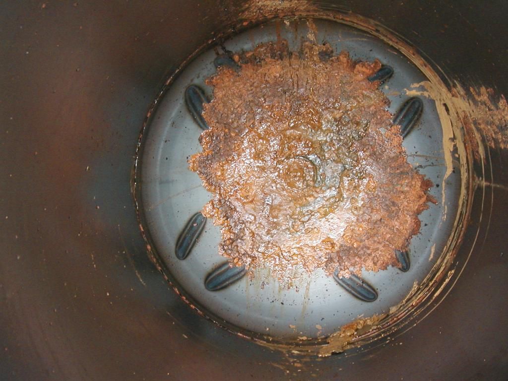

Despite having drained the tank after each usage, this is what I found inside the tank. Note the lack of ANY rust preventave coating--way to build 'em guys!Image
After trimming the bottom of the "keeper" tank I treated the inside with phosphoric acid to "convert" the rust. I'll wash off the excess, dry and coat the inside of the tank in an effort to extend its life.Image

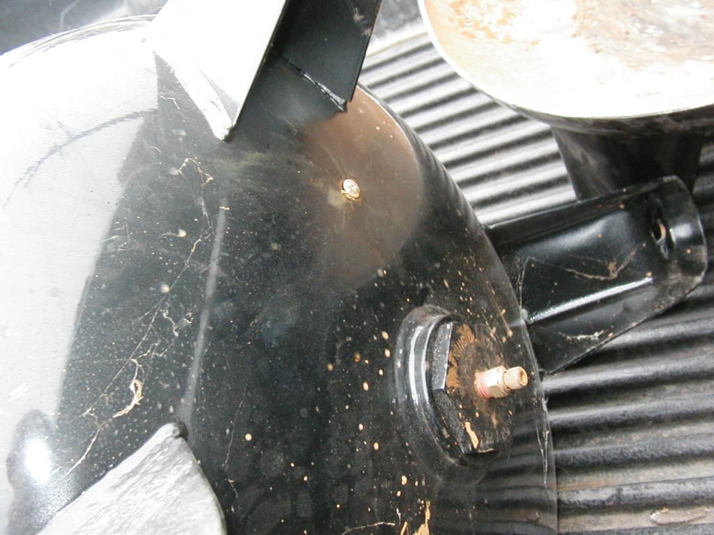

Hello All. While I havent quite finished the repair on the compressor I do now know what happened to cause the bung to rust out. A small hole was drilled in the bottom of the tank and then the large bung was welded over the hole-- scab like. This created a pocket for water to collect in with no way to escape. That and no rust proofing were a perfect combination for a near disaster.

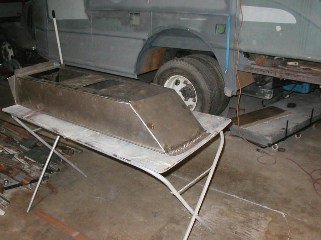

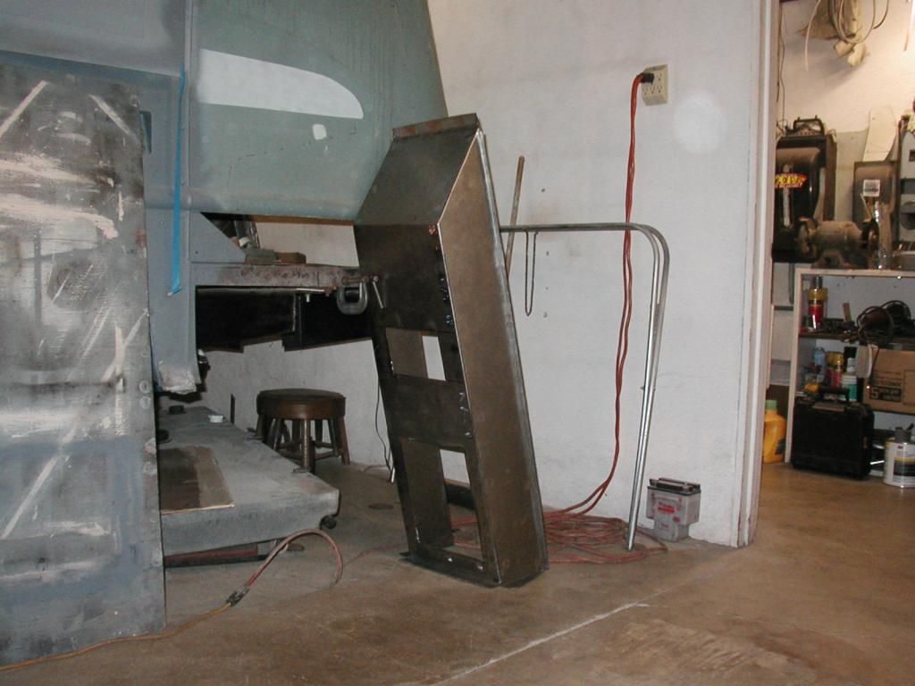

I spent a pleasant and uninterupted day working on the bus. I fabed up the cover for the instant water heater. It was a challenge because of the compound curves at the rear of the bus but that just makes it more fun :screwy: . I made a couple of design changes on the fly so now the cover will also provide cooling to the heater exhaust through convective draw as well as house the two, 3 gpm water pumps (any leakage from the pumps will run out the air inlet for the heater and not soak the floor).
Jack
The cover is about 4' tall, 7" thick and 14" wide. It will be sealed against the rear wall and floor of the bus to prevent carbon dioxide escaping into the living area.Image
Another view of the cover showing the angle it is at when installed. I will make screw on covers for the two access holes. The small hole is for the heater control and the large hole is for access to the pumps.Image
