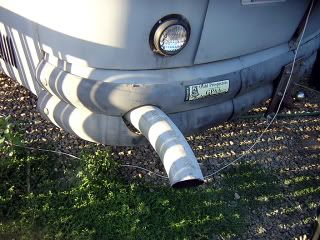

Well, that huge stupid hole is where the exhaust pipe used to exit the bus - through the bumper. I've been trying for years to find an affordable replacement for that quarter section of bumper, but so far, no one has stepped forward with a decent replacement. Guess it'll just have to remain ugly until I make a trip to CA and visit a bus wrecking yard and get my pockets picked by the Gomer behind the counter.

Yea , I was just razzin ya a bit. I know a couple places here that I might be able to score one. Probably cost more to ship than the price of the bumper tip. If I find one for around $20.00 ya want it??? Is it just the top piece? I figure the top and bottom are the same, probably all four are the same from left and right side. Mine has the hole thats split between the top half and the bottom half. Heres a pic. Also some small holes drilled in the top lip to hold the sheet metal as shown in pic. I know the exhaust pipe is "long" but it keeps the soot off of my bike!!! Image

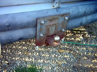

Heres the trailer hitch I made also. The bumper is not really strong, so I just haul a small utility trailer with a bike in it.Image

That exhaust looks deadly. I would have scars on my legs if I had to be around that!
