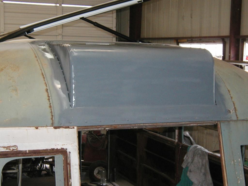

I think that little beauty will fit right on--don't you? And, I won't have to worry about my shower staying damp with that vent!Image

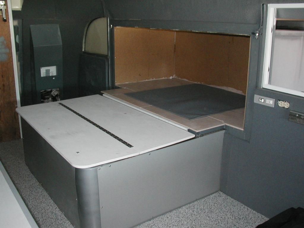

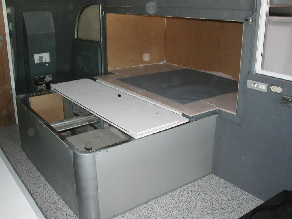

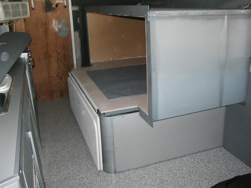

Hello All. Since I want to get the upholstery completed this week I figured I'd better finish the bed mechanism to allow for that completion. The final form of the bed looks something like a cross between a futon and a murphy bed but does allow for a queen size bed while still retaining walk around space in the bus even when the slide out is retracted. I plan eventually to have a foam mattress but for the time being I'll use my inflatable mattress. Jack
I used stainless steel piano hinges, 1/2" plywood and some angle iron for the mechanism. Image
This pic shows the bed frame folded in and the slide out retracted as it would be for travel. The walkway in the center of the bus remains clear. Image
Here the slide out is shown extended with the folding mechanism still folded back on itself. The small black knob is used to keep the pieces of the fold up from opening out when in the travel position. Image
Bed frame folded out. Image
I couldn't resist a short nap once the mattress was deployed :lol: . Image
