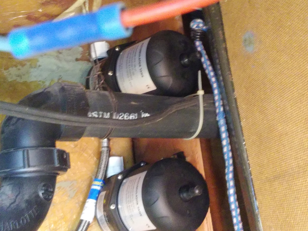

When I built out the bus I installed two water pumps. One pump for cold water and one for hot because the on demand water heater required constant water flow and pressure to operate. Functionally that worked fine. However, when I wanted a mix of hot and cold water at the tap both pumps ran for short bursts producing water pump based version of dueling banjos that set my teeth on edge. The cure was the installation of an accumulator tank on both water lines—no more dueling banjoes!
[img]https://i.postimg.cc/DZDg6xrG/20191219_ ... urst01.jpg[/img]
